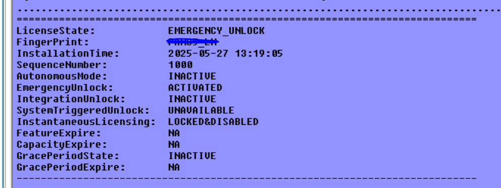

how can i check permanent license at moshell, how long is valid?
hi, @salebgd, try command invl
Thanks. Do you know how to get shorter output, only this without all features(winfiol or CLI). And do yo know where in ENIQ to find information about licenses. I know about basic tables like DC_E_ERBS_EUTRANCELLFDD_DAY etc
I believe it is parsed Lm=1 object and some objects under them. About ENIQ - sorry, I don’t have it.
In ENIQ you can see the license information in the TP BULK CM tables, for example DC_E_BULK_CM_CAPACITYSTATE_RAW, DC_E_BULK_CM_FEATURESTATE_RAW, and you can also see the usage of some of the capacity licenses in the DC_E_TCU_CAPACITYUSAGE_RAW tables.
