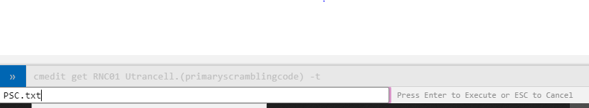

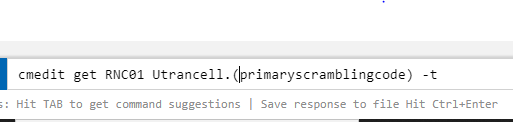

cmedit get RNC01 Utrancell.(primaryscramblingcode) -t
Before executing above command,
hit cntr+enter then write any file name as shown below and then Hit enter to save. You will get whole RNC Utrancell PSCs.
just change rnc Name RNC01 and UtrancellId as per your network. You will get the PSC for the cell/site you want,
For multiple sites/cells, you need run above 2nd command and download file.
