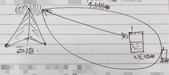

A base station / eNodeB transmit power is 43 dBm and UE max power is 23 dBm.
At how much power will eNB provide PRB to this UE?
What would be PRB power / RE power?
How to calculate power of one Resource Element?
Resource Element power if fixed or variable as per UE distance is that geographical area?
![eNodeB - UE power calculations](/uploads/db2683/original/3X/f/a/fada8f02273d75c347b1c51b2814bc1b750aa4b6.jpeg)
40w / 10 MHz or 20 Mhz BW.
40w / 100PRB, RE power remains same unless certain mobility features activated.
UE power depends on location in indoor for a geo area its being served incl path losses across.

Suppose the following:
A user standing 100m far from the enodeB and B user standing at 150m.
For both A & B user will RE Power be the same?
Thats your control signal and traffic will vary based on DTX both sides.
