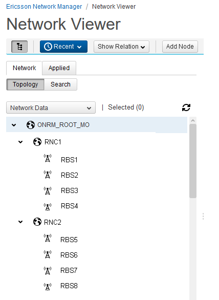

In ENM; I want to move an RBS from SubNetwork RNC1 to SubNetwork RNC2… does anyone know if it can be done with cli?

We have many RBS’s that should be moved from RNC1 to RNC2, and its a big job to manually delete them in ENM, and then create them again under the other RNC…
Hi, @Bartonsen the only way I know is to delete from one subnetwork and create under another. I will search python script if you need it.
Thanks. That is how we have been doing it (delete and add again). But its timeconsuming when you want to move 20+ RBS’s…
It would be perfect if it could be done with cmedit from Command Line Interface…

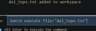

Both can be executed with cli command:
batch execute file:"del_topo.txt"
batch execute file:"cre_topo.txt"

I need to ask one final question…- its the first time I use scripting for this.
From where should the output files be executed?
Using the Shell Terminal on Scripting, I get cmedit: command not found
Its possible to use Command Line Interface and enter the commands one-by-one, but how to run them all in one batch?
It is not needed to execute it line by line. Open CLI web app and drop file to browser window. Then command is:
