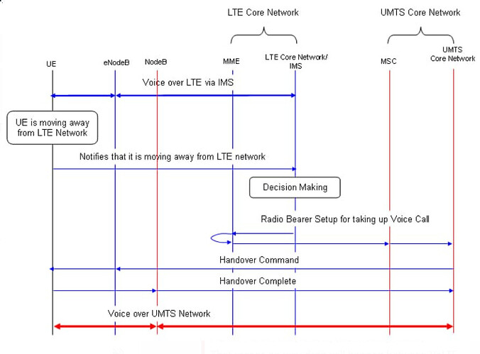

To do what you want in this case, either convert this to CSFB then go out from the VoLTE site (which will cause service interruption) or go through SRVCC to continue this call on 3G/2G.
Check out attached signal flow:

eNB filters out target cells which don’t support volte services (this is controllable through switches in some vendors).
Now as UE moves out of coverage of VoLTE service, it will perform SRVCC.
