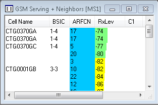

Dear All, Muslim greetings Asslamu Alaikum. I am facing the following problem while doing drive test on gms/2g/2.5g network.In the “GSM serving + Neighbours [MS1]” window I found the same cell is showing 2 times but it should not be…Can any one expert can tell why this is happening ?

Yes RangaChimombe sir, I am using concentric cells in Huawei system ? But why it is showing 2 times the same cell ?

I think its a bug in TEMS due to cracked version, I also faced the same issue. And the cell which it repeats 2 times is mostly the serving cell.

Dont worry about the repetitions, Just carry on analyzing.
Check if the BCCH is not defined in MA List. Usually its a precondition for intra cell handover between underlaid and overlaid cells

you can see that to enable intracell handover the concentric cell is made an adjacent cell automatically in the Hauwei Algorithm
