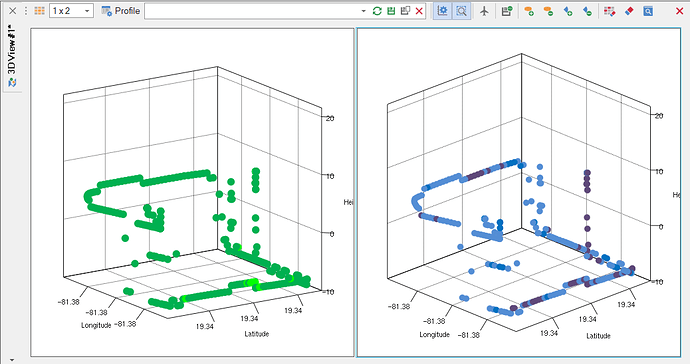

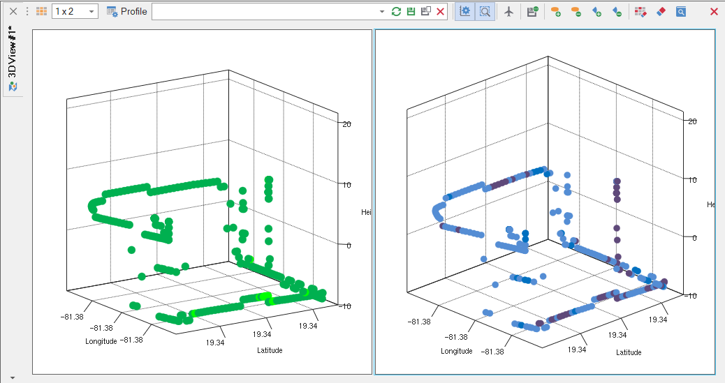

FYI, Focus Analyzer (https://sanworl.com) can display the drone test data in 3D chart view, allowing zoom in, zoom out, and rotation.
Peter
