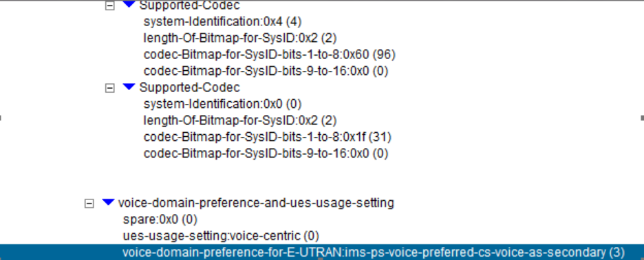

As 4G, if network support VoLTE it will indicates network capability to UE in SIB first. Then during attach request, UE will send whether its support IMS-voice and supported codec mode like below picture.
I think 5G VoNR also the same behavior.
