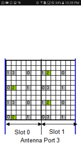

Depends for 2T2R % is different and for 4T4R % is different
Do you have a table or info about it you could share? Please
There is relation between RS power and both carrier BW and total transmit power
Perfect, I appreciate it.

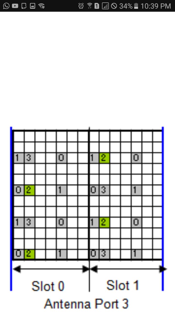

For 4T4R shouldn’t be 16/84= 19% ???
You will have 4tx and 4 RE’s going for each one
Great, thanks
