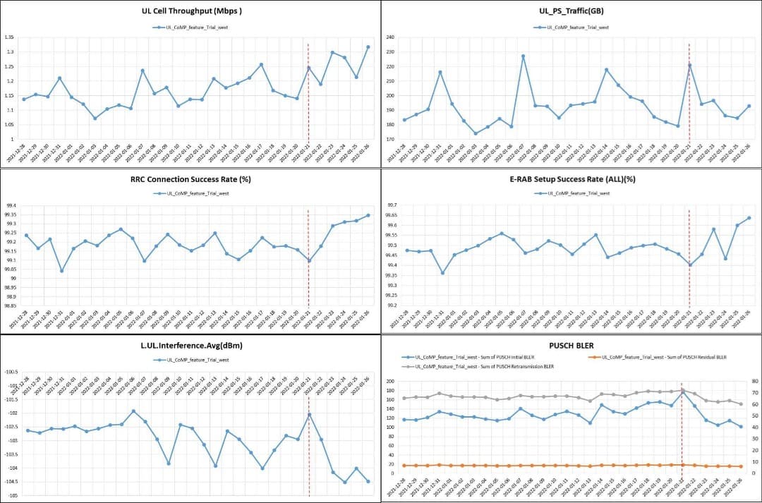

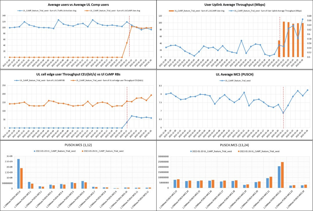

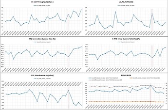

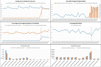

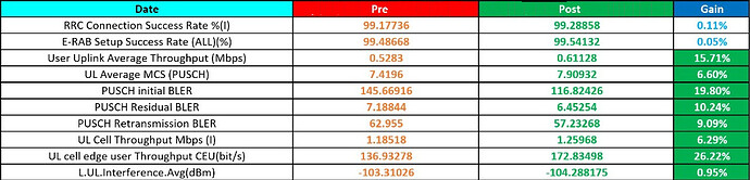

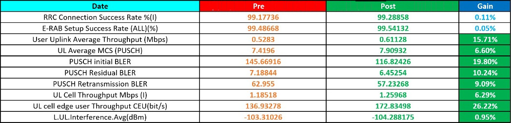

  • User Uplink Average Throughput had excellent improvement following the increase of CoMP RB ratio which indicates more gains provided by UL CoMP.
  • L.ULCoMP.User.Avg increased after activation which indicates the UEs that got gains from UL CoMP.
  • UL cell edge user Throughput had good improvement which will enhance edge user experience
  • UL Average MCS Modulation code scheme on ( Physical Uplink Shared Channel )PUSCH had very good improvement which will increase the UL throughput.
  • We can notice that PUSCH MCS index decreased in low Modulation code schemes and increased on high Modulation code schemes which will give users better data transfers .
  • PUSCH BLER had very good improvement since the PUSCH carries both signaling and user data so over all KPIs improved after we improve the channel quality .
  • UL Cell Throughput had excellent improvement .
  • L.UL.Interference.Avg decreased by more than 1dbm .
