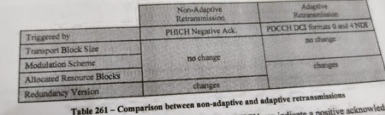

eNodeB has info about RVI and MCs which it can used by downlink flexibilble in adaptive retransmission whereas in non adaptive it doesn’t change.
For harq in uplink this one used which depend as below.
Yes, thanks @techieambitious.
Uplink has both, downlink uses adaptive.
