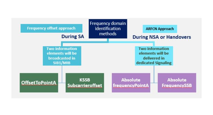

GSCN is Global Synchronization Channel number and, in my opinion, does not reflect offset to point A and KSSB.
KSSB is in MIB 5G.
offsettopointA is given in RRC reconfig to setup 5G in NSA.

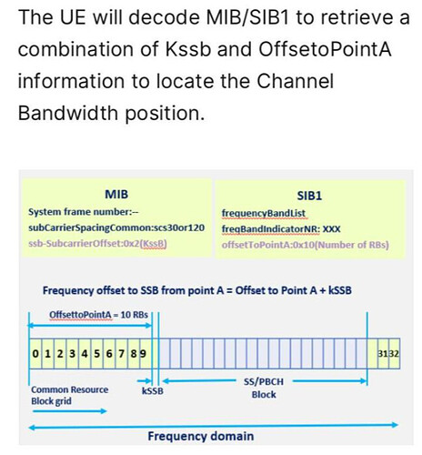

Offset to point A represents RB 0, RE0 location.
Bottom of the used spectrum for an operator.
While GSCN is location of SSB where UE needs to search for signal for SSB sync.
If I undertand question correctly: OffsettopointA specify the RB offset between CRB0 and CRB overlaps with the start if SSB; and Gscn in general used to degine SSb center freq and offsettopointa and kssb is delivered to UE to identify the SSb position from the channel bandwidth as the UE detect ssb blindly and is mot aware about the exact freq location.
Offset to point A: Sent to the user to locate the exact position of SSB after the UE detected the SSB based on GSCN (center SSB freq).

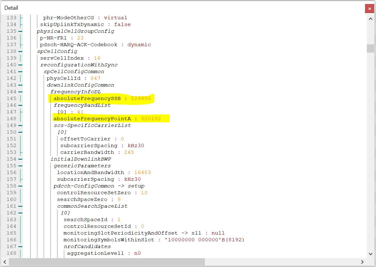

I’ve seen logs in SA it has offsettopointA.
So GSCN for NSA only, right?
You will find it only in SA and this will be delivered in 5G SIB1.
GSCN can be used for both brother but it is mainly designed for 5G SA.

So if UE know SSB based on GSCN why to use offesttopointA?
UE doesn’t know the location of SSB in the channel bandwidth.
It needs to know the exact location in the channel bandwidth.
So this will be known through offsettopointA.
