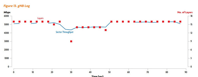

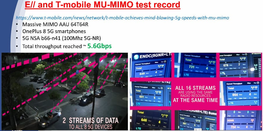

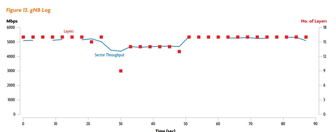

Recently Ericsson and T-mobile record 8 UE MU-MIMO 5G throughput total 5.6 Gbps.
They said theory is 5.9 Gbps.
I also read that report, this is what they achieved:
