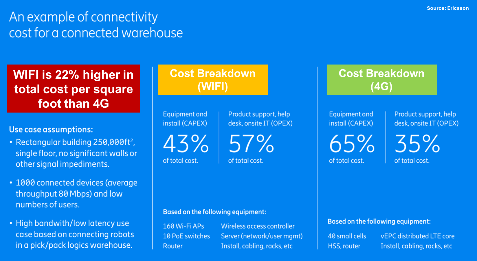

    • Me: It depends on how much coverage can be provided by both systems as maybe one 4G/5G node can cover the same area as 4 or 5 WIFI nodes. So, I brought to you here one interesting example that is done to build a private network in a warehouse with a comparison between using WIFI and 4G, so we’ll know what equipment is needed in both cases? Also, we’ll understand the cost of each solution and see which one is cheaper assuming both solutions will provide similar coverage and customer requirements. This warehouse is a rectangular building 250,000 ft2 (0.023 km2) with a single floor, no significant walls or other signal obstructions. So, let’s see this nice comparison.
  • My friend: This is interesting, please show it to me.
    • Me: Here is our example (please check the below figure). The warehouse has 1000 connected devices (average throughput 80 Mbps) and low numbers of users. High bandwidth/low latency use case based on connecting robots in a pick/pack logics warehouse. And to cover it using WIFI, we need 160 Wi-Fi APs (Access Points), 10 PoE (Power over Ethernet) switches, also router, installation, cabling, racks, etc., while if we used 4G, then we’ll need 40 small cells, vEPC which is the LTE core, router, installation, cabling, racks, etc. And the final result is showing us that the “Wi-Fi is 22% higher in total cost per square foot than 4G” with more CAPEX for 4G compared with WIFI, but 4G has less OPEX. So, this use case is clear evidence that 4G/5G private networks can be cheaper than WIFI, but again we should evaluate both solutions in every situation.
