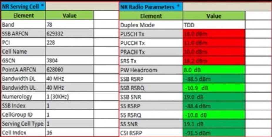

What is the difference between SSB RSRP, SS RSRP, CSI RSRP?
Same for RSRQ & SINR?
May anyone explain all parameter?
Seems:
  • SSB RSRP at L3
  • SS RSRP at L1
  • CSI RSRP for csi-rs beams for coarse beams if enabled
Thanks.

ss-RSRP represents the average power received from a single Resource Element allocated lo the Secondary Synchronisation Signal.
synchronisation Signal - Reference Signal Received Power’ (SS-RSRP) measurements are used for cell selection, cell reselection, power control calculations, mobility procedures and beam management.
CSI-RSRP represents the average power received from a single Resource Element allocated to the CSI Reference Signal
‘CSI Reference Signal Received Power’ (CSI-RSRP) mcasuremen1ts arc used for connected mode mobility, power control calculations, and beam management.
