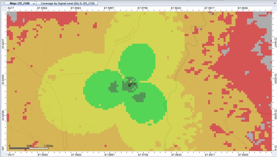

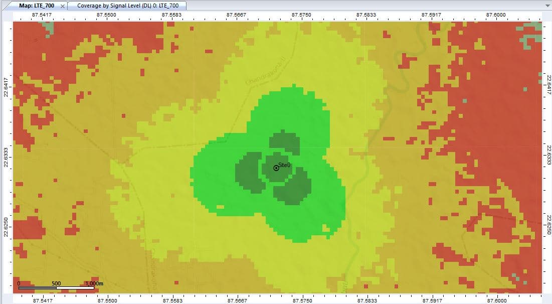

He is planning for 2100 & 700.
But 2100 coverage is larger & better than 700!
So which parameter he needs to check for resolving this issue?
Antenna file, antenna Parameters, Power Parameters, Radius or any other thing?
2100:
700:
Propagation model seems to be a bit out of place.
You can ask your friend to use Aster/Crosswave propagation model and select frequency dependent parameters judiciously.

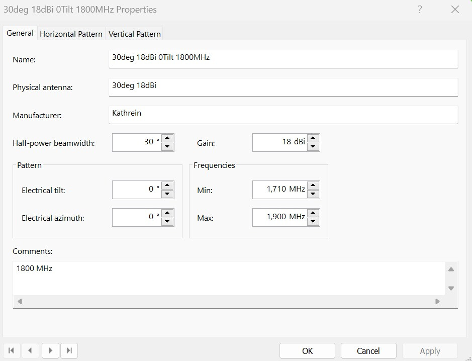

Kindly check first (if all parameter power node B configuration on each layer all the same):
Antenna Parameter (usually in atoll each frequency has different configuration, gain & beam pattern).
