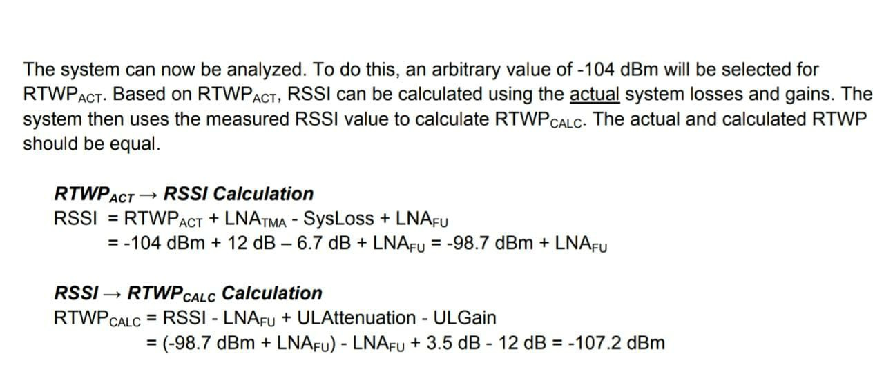

Can you please help us to understand RSSI and RTWP difference?

What is the difference between RSSI measurement and RTWP measurement (Ericsson) in LTE?
  • RTWP is calculated for each antenna , if you check counters for KPI it includes all PRB’s.
  • RSSI counters for both PUSCH and PUCCH includes calculations noise from -92 through -121
I tried to understand the way they calculated? Why measurements are between -92 and -121? And how they get this value? Is it from PUSCH and PUCCH Reference Signals (UL)?
