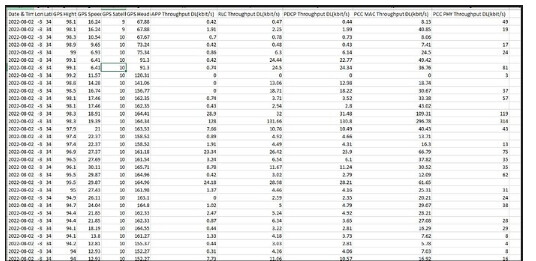

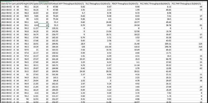

See some values below:
I can see MAC Throughptu is greater then PDCP.

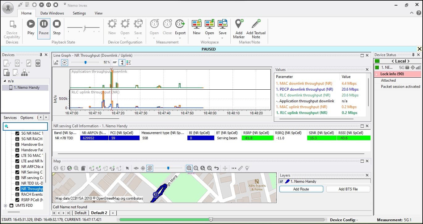

In this Picture MAC Throughput is less than other and Application Throughput is N/a?
How do we understand this?
What is the BLER?
What is the RLC mode?
If RLC mode is UM and BLER is very high.
