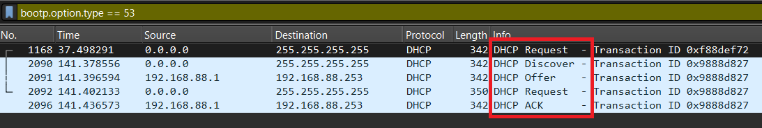

Understanding DHCP Using Wireshark.
The basic process of client receiving configuration information from a DHCP server works is a four-part interaction.
As DHCP is implemented as an option of BOOTP, you can filter on BOOTP messages.
bootp.option.type == 53

There are four messages sent between the DHCP Client and DHCP Server: DHCPDISCOVER, DHCPOFFER, DHCPREQUEST and DHCPACKNOWLEDGEMENT. This process is often abbreviated as DORA (for Discover, Offer, Request, Acknowledgement).

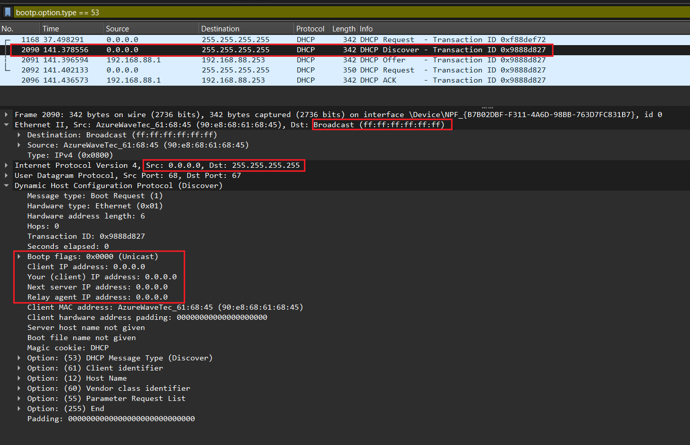

DHCP Discover.
This first step is a discovery process performed by the workstation. The workstation here refers to the system that currently does not have an IP address. The purpose of this step is to discover any DHCP servers on the network that can hand out IP configuration settings. The workstation accomplishes this task by sending out a broadcast over UDP port 67 that essentially asks, “Hello, are there any DHCP servers available to help me?” This message is referred to as a DHCP Discover message.
Because the client has no way of knowing the subnet to which it belongs, the DHCPDISCOVER is an all-subnets broadcast (destination IP address of 255.255.255.255, which is a layer 3 broadcast address) and a destination MAC address of FF-FF-FF-FF-FF-FF (which is a layer 2 broadcast address). The client does not have a configured IP address, so the source IP address of 0.0.0.0 is used. The purpose of DHCPDISCOVER message is to try to find out a DHCP Server (a server that can assign IP addresses).
In a network with multiple subnets separated by routers, DHCP broadcasts typically do not traverse these router boundaries because routers, by default, do not forward broadcast traffic. However, to facilitate DHCP operations across multiple subnets, you can use a feature commonly known as “DHCP Relay” or “IP Helper.”
By using DHCP Relay or IP Helper, you can have a centralized DHCP server (or servers) serving multiple subnets, reducing the need to deploy a DHCP server on each subnet. This is particularly useful in larger networks to efficiently manage IP address assignment.

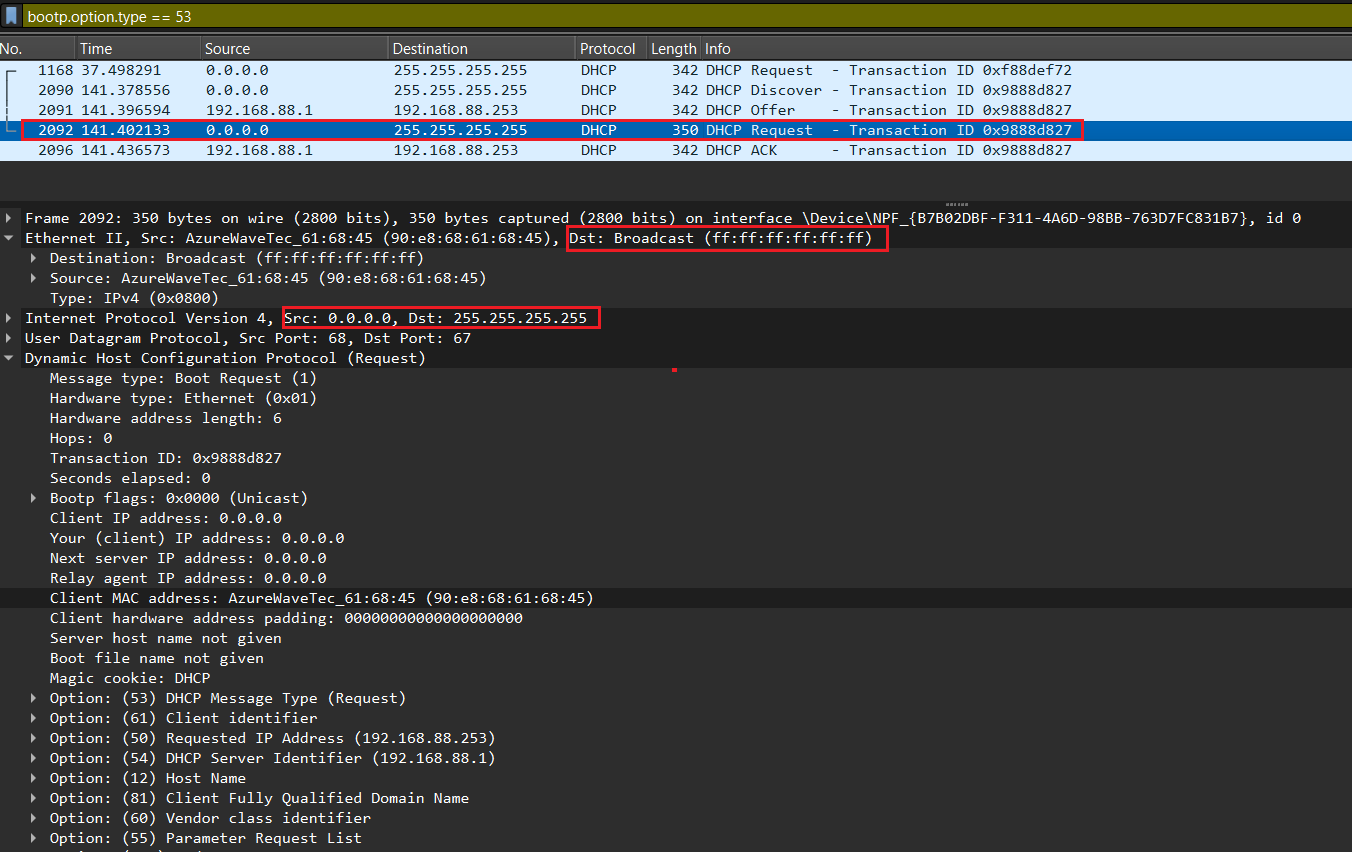

DHCP Request.
If the client accepts the offer, it then broadcasts a DHCPREQUEST message saying it will take this IP address. It is called request message because the client might deny the offer by requesting another IP address. Notice that DHCPREQUEST message is still a broadcast message because the DHCP client has still not received an acknowledged IP. Also a DHCP Client can receive DHCPOFFER messages from other DHCP Servers so sending broadcast DHCPREQUEST message is also a way to inform other offers have been rejected.

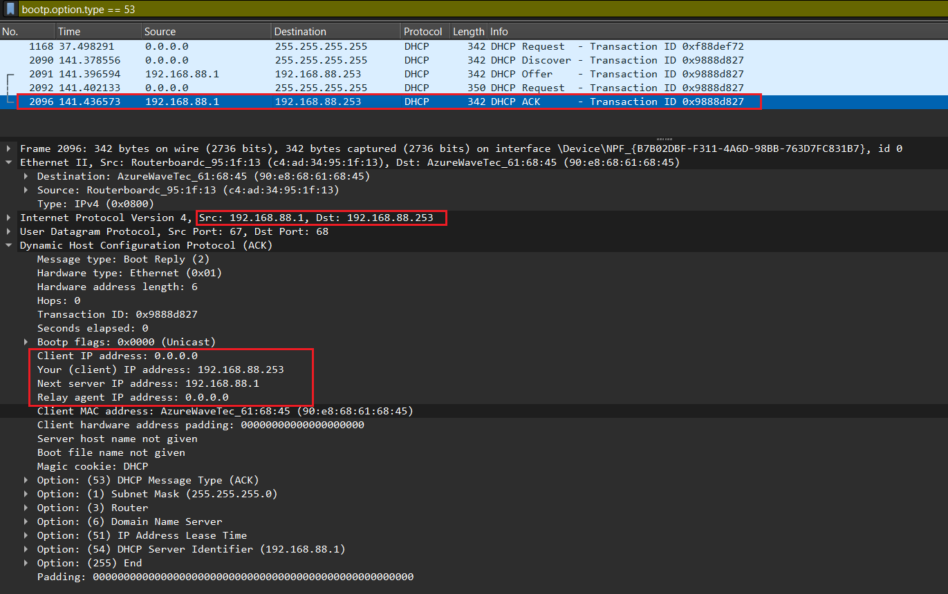

DHCP ACK.
The DHCP server that was responsible for the DHCP request responds with one last broadcast to the workstation and all other DHCP servers over UDP port 68. This DHCP Acknowledgement Message tells the other DHCP servers that the new IP configuration settings are owned by this particular workstation and cannot be reused for anyone else.
After receiving DHCPACKNOWLEDGEMENT, the IP address is leased to the DHCP Client. A client will usually keep the same address by periodically contacting the DHCP server to renew the lease before the lease expires.
