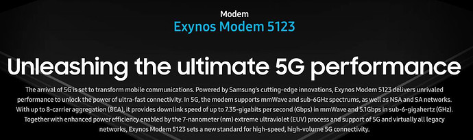

Does 5123 support 8CA as mentioned on Exynos website?

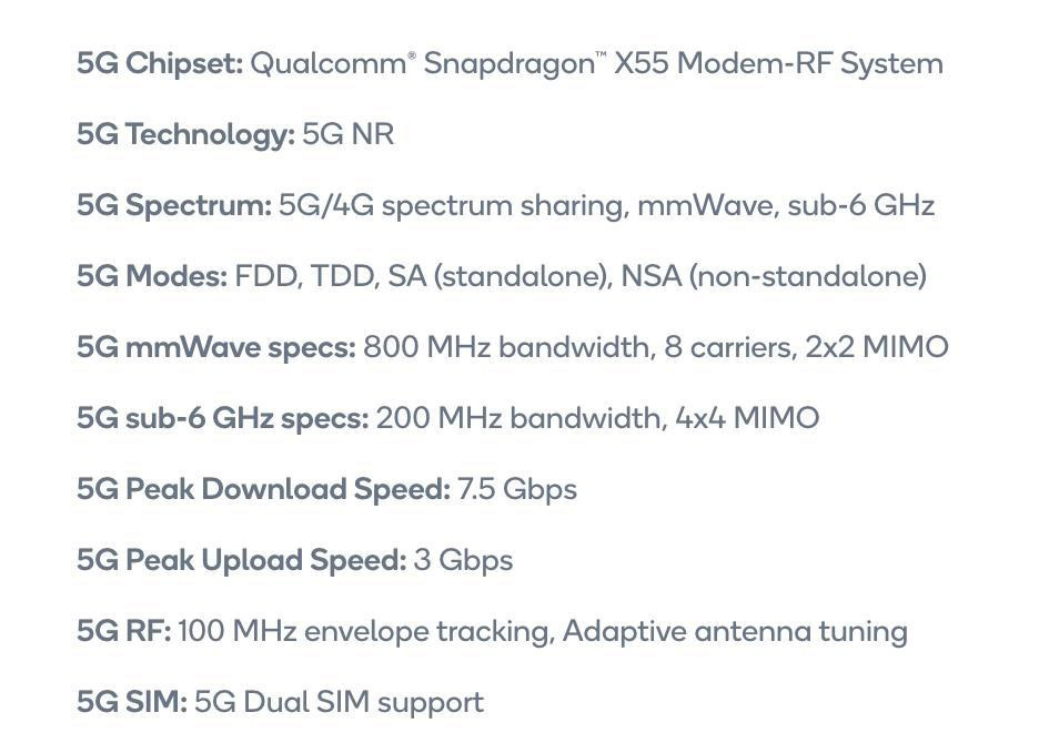

X55 page also says 8 carrier support in mmWave:
Yes indeed, it is max 2x2 mimo in FR2.
(I confused max MIMO with max CC for FR2)
