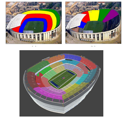

You need to do a coverage planning and capacity planning of you area of interest
Incase there are already existing sites which can cover your stadium you can work more on the capacity planning and how to increase the capacity of your RAN equipments.
https://www.fujitsu.com/us/Images/4G-Femtocell-for-Football-Stadiums.pdf
Solving the problem is easy, simple and cost effective.
Install a small cell overlay to enhance traditional DAS Coverage.

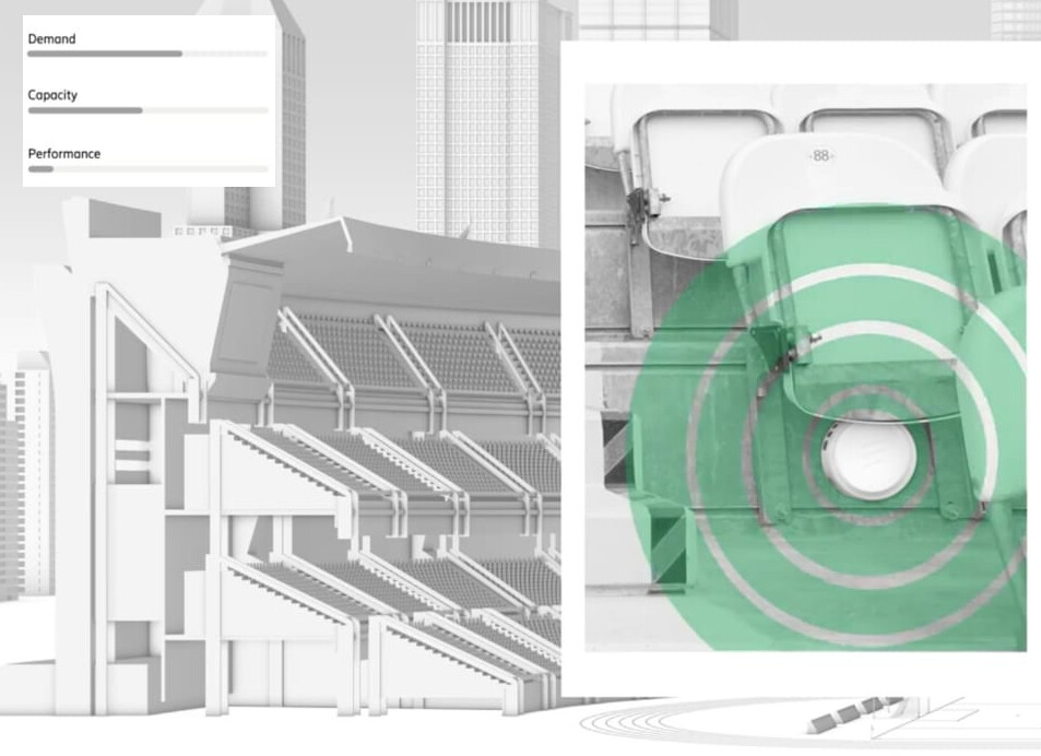

Use low power coordinated small cells, like the Ericsson Radio Dot System, under the stadium seats.
Also, check this old, but interesting article:
https://www.mobilesportsreport.com/2016/03/betting-the-under-putting-wi-fi-antennas-under-seats-is-the-hot-new-trend-in-stadium-wireless-networks/
I think WorldCup antenna installed like this.
Many small cell under seat…
Anyone having more details? Like power, gain etc?
:fearful: under seat :seat: no it might damage the most important parts… I never recommended suggest and opt for it.
