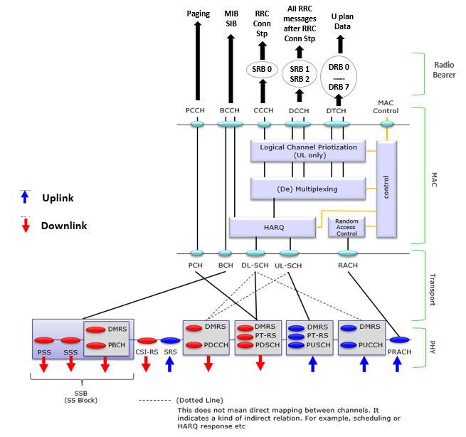

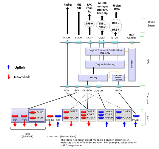

Let us understand the Data layer channels in 5G?
This are the most common question asked in interviews:
· Control Channel ==> Carries control and configuration information.
· Traffic Channel ==> Carries only data traffics.
· Max. No of layers in Layer mapping ==> 4 for UL & 8 for DL
· Maximum number of TBs that can be delivered to physical layer ==> 1 for UL & 2 for DL
· What are types of channel coding in NR?
  • PDSCH, PUSCH = 4 LDPC ( L ow D ensity P arity check C ode)
    • Channel coding on the traffic channel.
    • LDPC corrects channel errors by maintaining parity bits for a selection of the data bits.
  • PDCCH, PUCCH = 4 Polar (Polar codes are the error-correcting code on the 5G NR control channels. Polar codes are unique in the way they split the channel into good and bad bit-channels)
