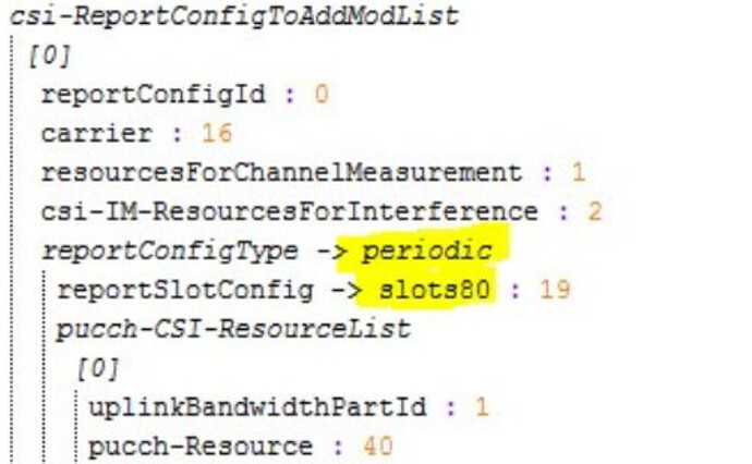

CSI Report Config
  1. resourceForChannelMeasurement: This is NZP CSI resource configuration each having resource set ID which contain set of NZP CSI resources.(This represent resource set ID)
  2. CSI-IM-ResourceForInterference: This is CSI IM resource configuration each having resource set ID which contain set of CSI IM resources.(This represent resource set ID)
  3. reportConfig Type: It is either periodic or aperiodic. If it is periodic then UE will use PUCCH resources to transmit CSI report & if it is aperiodic then UE will transmit CSI report on PUSCH. Semi persistent can be transmitted either on PUCCH or PUSCH.
  4. reportSlotConfig: It is applicable only for periodic and semipersistent. It will define the slot and offset.
    Ex:- slot80:19 means CSI report will start transmitting from slot 19 and after every 80 slots it will transmit periodically it means slot 19,99,179…(This slots must be uplink slots).
  5. uplinkBandwidthPartld: It represents the BWP( 0 to 3) For each BWP CSI report will be transmitted using that specific BWP uplink PUCCH resources.
  6. PUCCH-Resourceld: This represent the resource ID of PUCCH that is configured for specific BWP(Each BWP has its own dedicated PUCCH config.).
