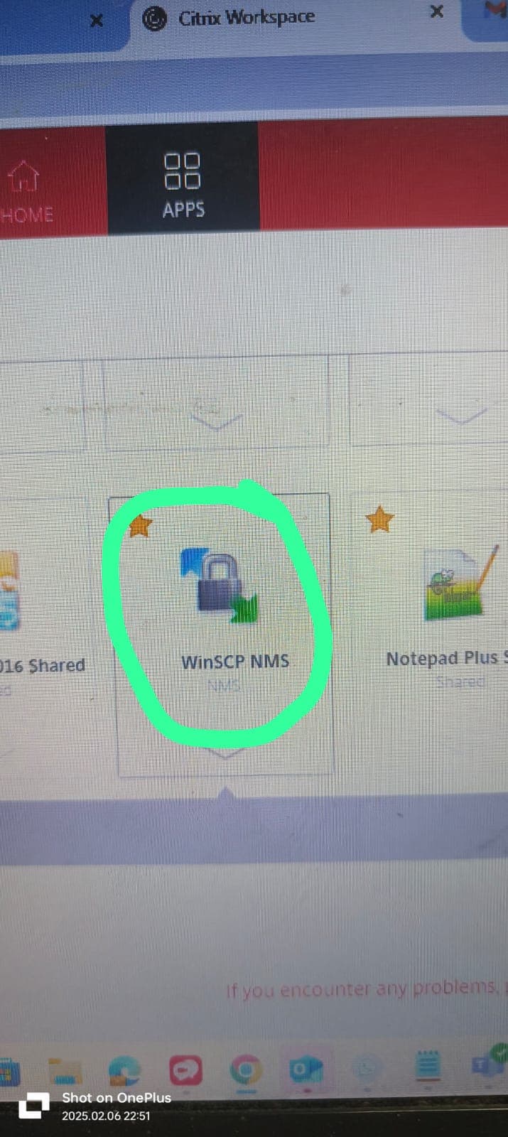

Use WinSCP.
WinSCP is a tool used for running scripts and managing configuration files.
If you have this tool, you can execute commands on multiple nodes.

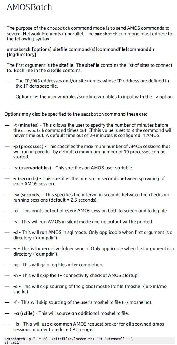

Maybe AMOSBatch could be helpful for you.
I believe you are already familiar with this procedure: :point_down:
you can use any unix commands via moshell/amos/amosbatch if you put ā€œ!ā€ or ā€œlā€ at the beginning of the line
!/l
Execute a unix command on the PC/workstation
Either the ! or l can be used.
Examples:
  1. l pwd (or the alias lpwd) - to know the current unix working directory
  2. l cd scripts/rbs3 (or the alias lcd) - to change the current working directory
