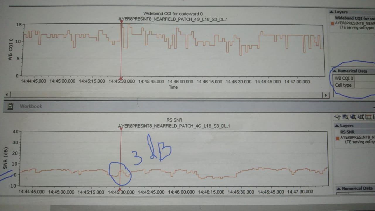

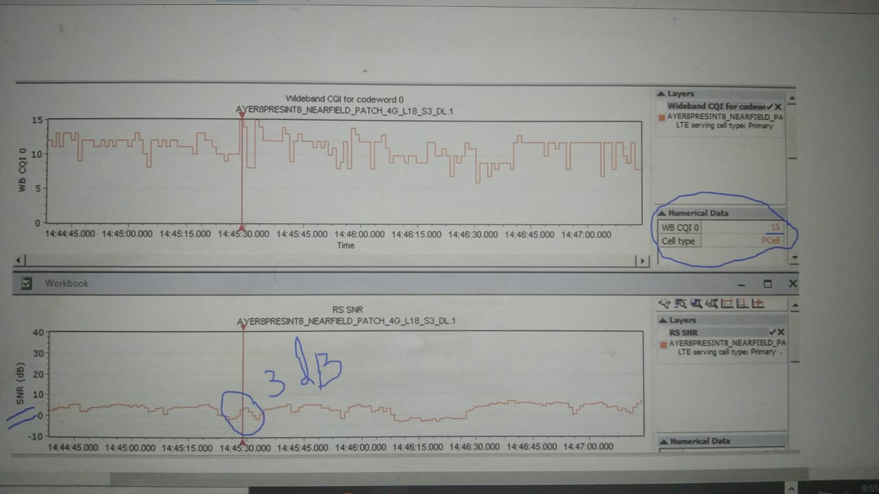

Hi Experts,
I have seen CQI as 15 at SINR 3.
Is it really possible?
CQI calculation is propritery of device vendor,and is generally calculated from PDSCH SINR. What you have shown you is RS SINR.
RS SINR can be poor due to CRS to CRS or CRS to PDSCH interference.
PDSCH SINR can be poor due to PSDCH to PDSCH or PDSCH to RS interference.
Since your CQI is highest…PDSCH SINR must be good. And RS SINR is poor may be due to mod3 collosions
If possible pls check PDSCH SINR.
