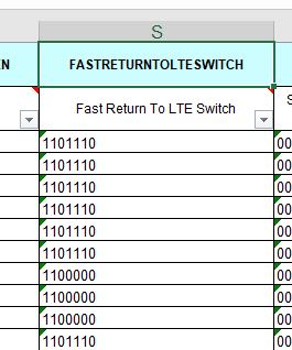

I need more clarification about the Fastreturntolteswitch parameter:
In Huawei vendor, when exporting the 3G cell parameters data template from planned area portal (U2020) the value of FASTRETURNTOLTESWITCH appeared as 0 or 1 composed of 7 digits as figure attached.
However in Hedex library the FASTRETURNTOLTESWITCH about six switches as mentioned below:

So kindly your clarification regarding:
Why in the export data existed as 7 digits and in the Hedex library the same parameter has 6 switches?
