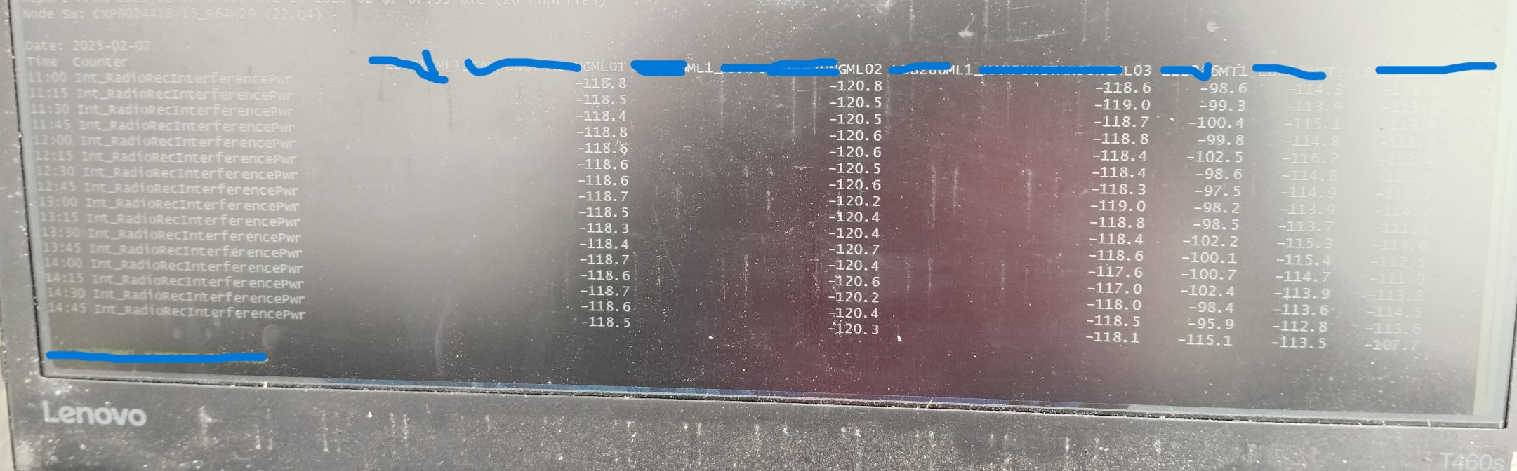

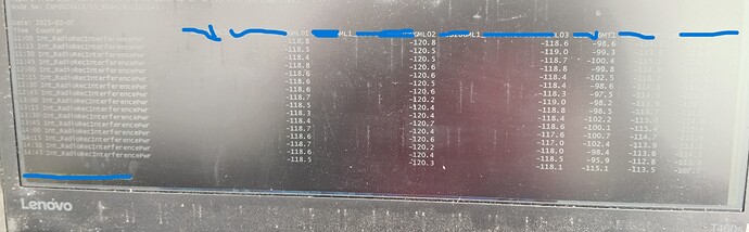

Do this command return an RX(dBm) value that could be the same as UL RSSI?
Neither of these commands is working. Do you have any alternative suggestions?
Is it a DUS or a Baseband unit?
Above commands are specific to Baseband.
Use this for DUS:
pmr -r 106 -m 24 | grep Int_RadioRecInterferencePwr
pmr -m 4 -r 206 -tz +7 | egrep Int_RadioRecInterferencePwr
pmr is not live check, it checks the last 15 mn value. For live check, use pmx instead.
