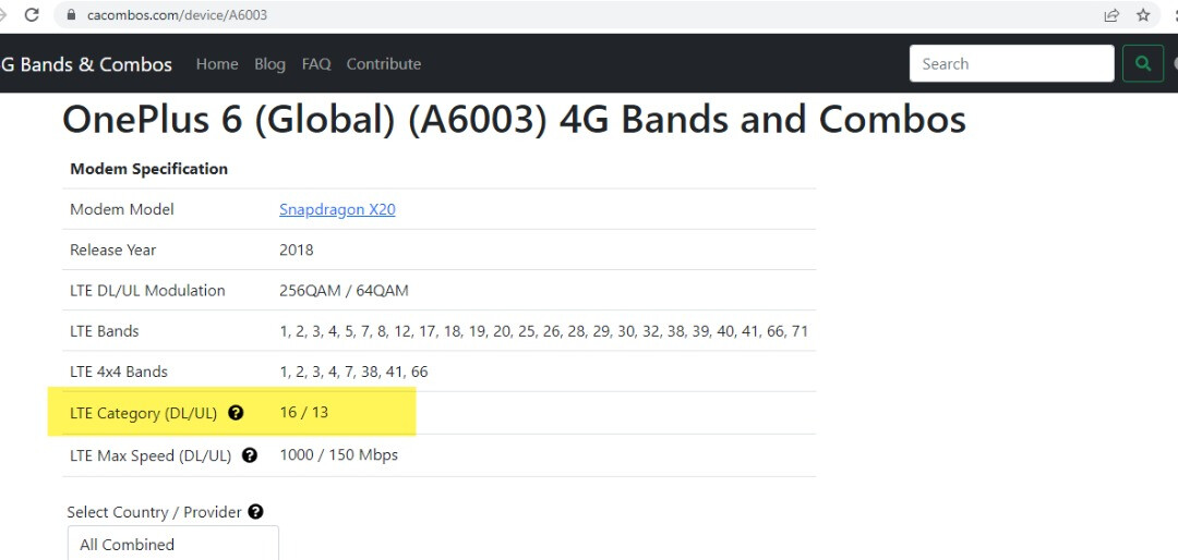

Can anyone help me read UE capability information RRC_UE_CAP_INFO?
For example my phone is oneplus 6 model A6003, in websites I can see it is UE cat 16(dl)/13(ul).
But in RRC_UE_CAP_INFO it is mentioned cat 12/13.
