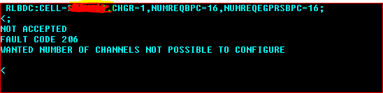

hello expert,
can someone advice in handling this error ?
RLBDC:CELL=REC1,CHGR=1,NUMREQBPC=16,NUMREQEGPRSBPC=16;
NOT ACCEPTED
FAULT CODE 206
WANTED NUMBER OF CHANNELS NOT POSSIBLE TO CONFIGURE
Hi, @King, you can add as many BPCs as TRXs*8, minus BCCH, SDCCH and other non TCH channels. Also NUMREQBPC >= NUMREQEGPRSBPC + NUMREQCS3CS4BPC.

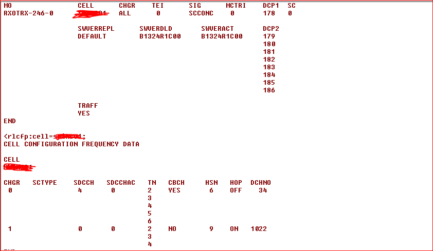

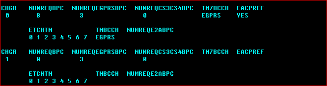

i have 4 TRXs
Channel group 0 and 1 have 8 NUMREQBPC each but i want to change the CHGR 1 NUMREQBPC to 24 ,
8+24=32, to match the number of TRXs but it is not working
Hi, are all TRXs connected to channel group ALL?
MO                CELL      CHGR    TEI      SIG      MCTRI    DCP1  SC
RXOTRX-1111-0     111111    ALL      0       SCCONC    0       178   0
MO                CELL      CHGR  BAND     ANT      MPWR
RXOTX-1111-0      111111    ALL   GSM900            43
And check the number of frequencies in channel groups RLCFP.
kindly find below the print out
Ok, add at least 2 frequencies to channel group 1:
RLCFI:CELL=CELL1,DCHNO=11&22;
I suppose it is synthesized hopping, so you can use DCHNOs from other or neighbour cells with different MAIO and HSN.
THANKS IT WORKED.
