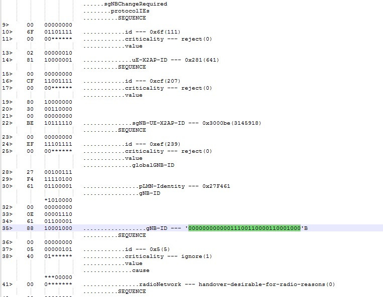

The gNB sent this message to eNB (Change Required) with gNB-ID — '00000000000011100110000110001000’B…
I means (7363)
But I don´t have gNB-ID 7363.
Any suggestions?
I means (7363)
Any suggestions?
Usually these values are in Hex.
Check E 6188.
Sure.
DEC is 942472. I have this gNB.
Is 942742 your gNB?
It is the T-SgNB. Thanks.
How can I convert this gNB-ID to DEC?
What is this B here?
Without B it should be 942472
Check that.
Thanks. How you converted it please?
