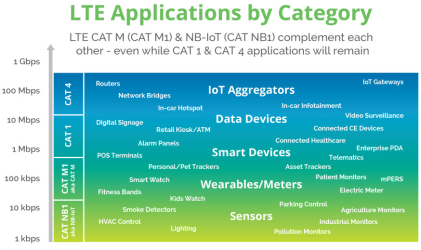

For LTE-based IoT networks to succeed, they need to have the following characteristics: 1) long battery life, 2) low cost, 3) support for a high volume of devices, 4) enhanced coverage (better signal penetration through walls for example), and 5) long-range/wide spectrum.

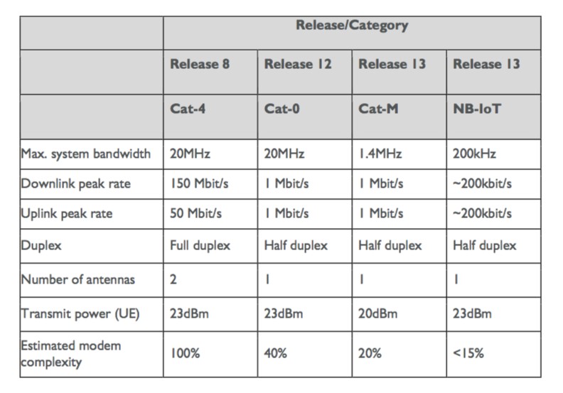

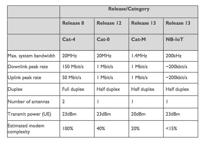

Cat-0 optimizes for cost as it eliminated features that supported high data rate requirements for Cat-1 (dual receiver chain, duplex filter). While Cat-1 is replacing 3G, Cat-0 is the protocol that set the groundwork for Cat-M replacing 2G as the cheaper option.
Cat-M1/Cat-M/LTE-M
Cat-M (officially known as LTE Cat-M1) is often viewed as the second generation of LTE chips built for IoT applications. It completes the cost and power consumption reduction for which Cat-0 originally set the stage. By capping the maximum system bandwidth at 1.4 MHz (as opposed to Cat-0’s 20 MHz), Cat-M has specific use cases for LPWAN applications like smart metering, in which only small amount of data transfer is required.
But the real advantage of Cat-M over other options lies in this: Cat-M is compatible with the existing LTE network . For carriers such as Verizon and AT&T, this is great news as they don’t have to spend money to build new antennas, although meshing Cat-M into LTE networks requires a software patch. The existing customer bases of Verizon and AT&T will most likely conclude that Cat-M is by far the superior option. Lastly, it’s almost certain that 5G and LTE technologies will coexist well into the 2020s, so the backward-compatibility of Cat-M is a bonus.

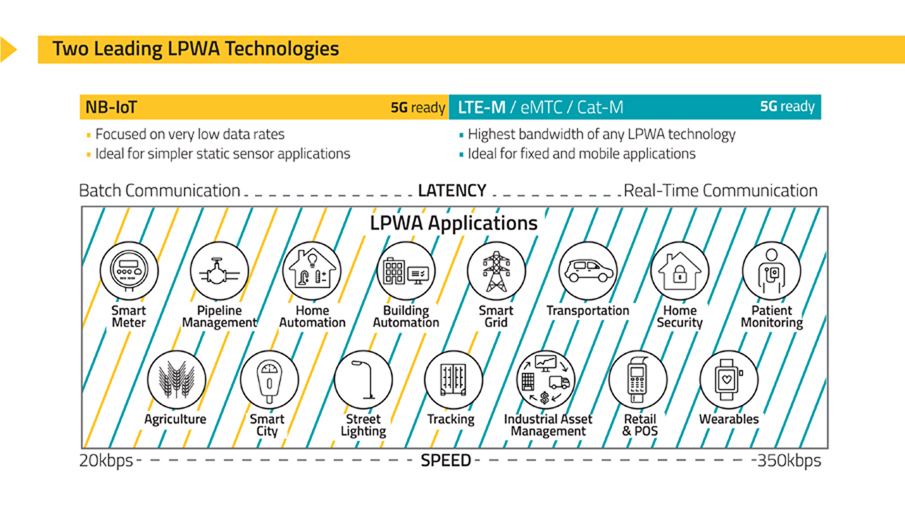

IoT covers a broad spectrum of applications. Sometimes you need high bandwidth, as with real-time surveillance. For asset tracking, data throughput is small, but there are inevitably many handovers as objects move. Smart meters and many smart city use-cases require small data transfer once or twice a day. This means that no one technology (even 5G) may fit the specific needs of an IoT solution/device.
