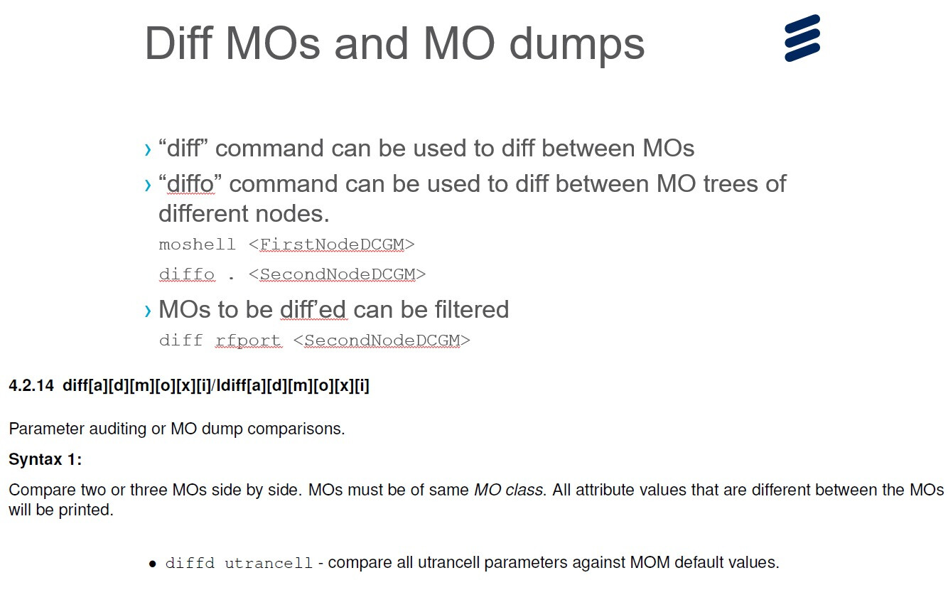

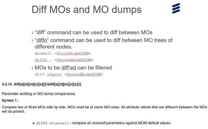

“diff” command (if you have access to Moshell)
Hi, you can use diff command in amos multimode like this:
  1. connect to both sites amos -m rbs1,rbs2
  2. compare to objects diff MeContext=rbs1.*RbsLocalCell=S1C1 MeContext=rbs2.*RbsLocalCell=S1C1
    check h diff for options to create file with differences
