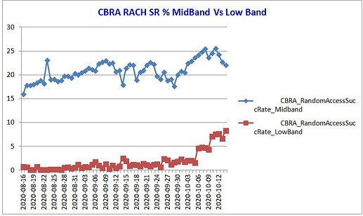

This is my network Intial RACH SR % for Mid-Band Vs Low-Band:
Its about 25 % Average SR % for Mid-Band.
For lower NR band approx. 8 %.
It depends on your B1 threshold.
B1 is -110 dBm currently.
You must get a lot of SCG failures during drive test due to RACH problem.
Do you have contiguous 5G coverage or just spots here and there?

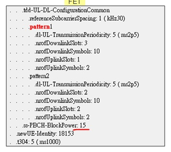

What is the ss-block pbch power?
It is in RRC reconfig message for NSA.
18 or 21 dBm? Or 15?
So you are expecting to deal with a pathloss of up to 125 dBm for RACH.
In Ericsson you can not adjust SSB Block power.
Yes, I know. You cannot adjust it.
Can you please elaborate 125 dBm?
And what is end benefit?
You will see during drive test that your UE has NR PUCCH power at 20 dBm most of the time.
This is a very clear indication that the link budget is limited in uplink and you are targeting too much coverage.
Path loss for RACH = 15 dBm - (-110dBm) = 125 dBm.
Also you will see in drive test analysis that UE fail to transmit during 10 preambles because it reaches 20 dBm power limit.
So RACH procedure will fail at message2
