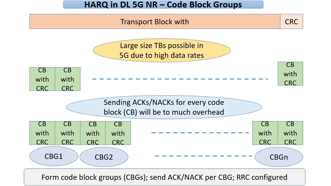

Question about CBG (code block group) retransmissions in 5G.
Say we have a TB scheduled in 5G that failed to be decoded by UE.
Inside that TB there are 24 CB(code blocks) among those 24, 22 were decoded correctly where as 2 failed to be decoded (I see that UE tries 16 times to decode them but still fails).
My question is: how gNB knows which 2CB failed to be decoded among the 24 sent?
Will this 2 CBs be included in a new transmission and will NDI bit will be toggled or not?
Not sure it is this way.
In my case, the very same TB was retransmitted again (although 22 CB were ok and 2 were nok) with another RV and MCS = 31( not changed) and recombine packets.
And it is the same procedure for all TBs that fails.
All are retransmitted again (with same TB size, different RV, using recombining between 1st transmission and retransmission and with MCS = 31).
Then what’s the use of CBs?
