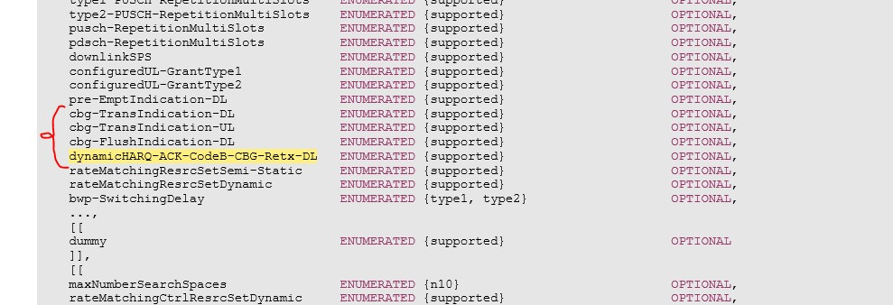

Question about UE capability 5G/NR: why we never see CBG (code block group) parameters for L1 retransmissions in UE capabilities?
I know are not mandatory to be mentioned, but how does UE work with CBG without informing NW about CBG parameters?
I am speaking about these UE capab:
Also if we search for “codeblock” string in logs, almost nothing is found.
How does 5G NW and UE operate together without exchanging info about codeblockgroup CBG?

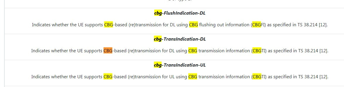

I think simply UE is not configured to work with CBGs.
Idea is that not all UEs support it:
So when UE does not report anything about CBG it simply does not support it.
And it will not work with CBG.
I think this is what we need to understand.
