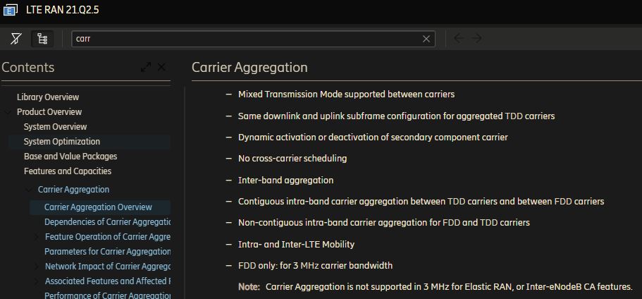

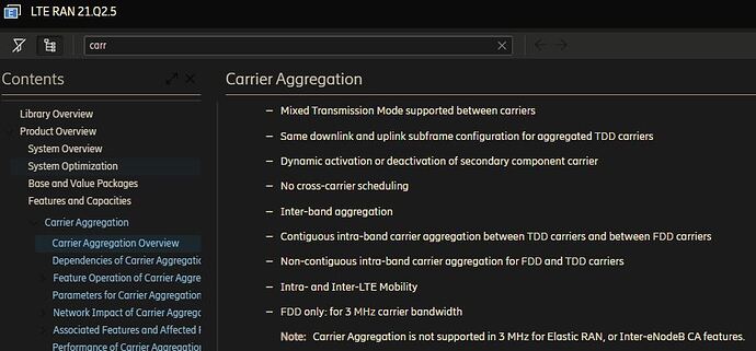

Carrier Aggregation is not supported in 3 MHz for Elastic RAN, or Inter-eNodeB CA features.
This is only limitation I have found
Hi my friend @vlr9999
Could you please share me the path or source where you got that info from?
Hi, it is from elex LTE RAN
