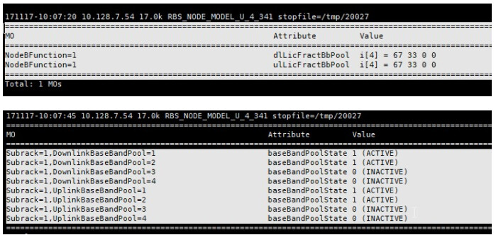

Carrier 3 not picking traffic! what do I need to check?
Carrier 3 not picking traffic what need to check. Nodeb is Ericsson and there is no alarm on site!
Core definiton
Ip rout
Basic parameter …
Basic parameters are ok. What in core ?
Cell must be defined at core side. Check the license as well
Yes , is defined in the core. Licence also ok.
Any other suggestions?
… Ip rout
Any command I can use to to check in OSS?
I’m only familiar with Huawei not Ericsson
New site ?
No. It’s an existing site
Was it fine before?
Yes it was
Try to reset node B
Done 3 times but still no improvement
Any traffic or only HS?
Totally no traffic
Can you please give the exact commands to check?
DSP UCELLCHK in RNC and Input the CellID. Put here the results
Not working!. Exact commands, please.
I am not connected now…run the command on the RNC with DSP UCELLCH…
Check Scribd for: 02 BSC6900 BSC6910 WCDMA RAN15.0
Get . Noofradio
This works.
Sorry not working in Ericsson RNC.
