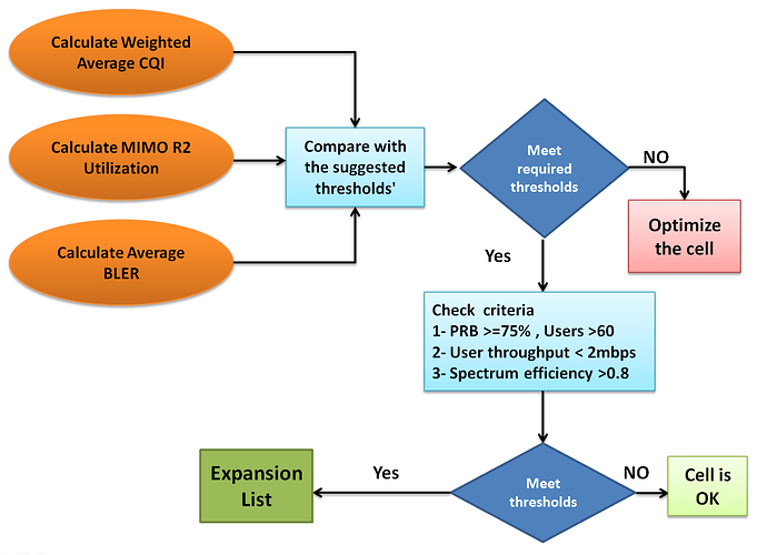

I am from Erlang_B table era… where we had channels, so it was straight to get the limit to trigger an expansion (new site or new carrier).
below process of expansion
Hello @CarlosFuente , the sequence generally advisable is:
  • PRB
  • Throughput
  • User number
  • Data volume
The process is somehow easy to define… but a lot of inputs can drive final result.
For example, one key point is to define the HMM. For example, take different HMM for each cell can lead to differences considering the Physical Sector.
Imagine a site, with several layers (for example several LTE bands 1800, 700000) … and for different technologies (3G, 2G…).
Should the “meet criteria” be for individual cell, or physical sector (the azimuth direction grouping all cells belonging to same physical sector)?

Usually in mature LTE networks PRB utilization is mostly >70-80% ( in my network)
So we usually check RRC connected users on hourly basis
if you have more then 1 band then you can go for load balancing first to same site or adjust HO parameters ( cio, A2 etc.) to share load with neighbors
If that doesn’t work then go for the capacity sites
To plan such sites you can consider:
Majorly Avg. RRC Connected users (hourly),
Low dl th put (make sure that site low thp due to traffic and not by any other reason)
Hope this helps :blush:
Probably the easiest approach is to consider the proportion of number of RRC Users (hourly) to “Desired” Maximum Number of RRC Users for given BW. Let’s say you decide that your 20M cell shouldn’t have more than 300 users at BH, - so 300 would be your magic number “Max RRC” for proportion. 10M cell may be half of it, etc. If at BH this proportion gives you percentage above certain threshold (let’s say 80%), your cell needs an expansion. Just tune these numbers for your desired user experience (like THP). PRB and THP are nice to consider as well, but these may have bad values due to number of reasons and not just high traffic.
