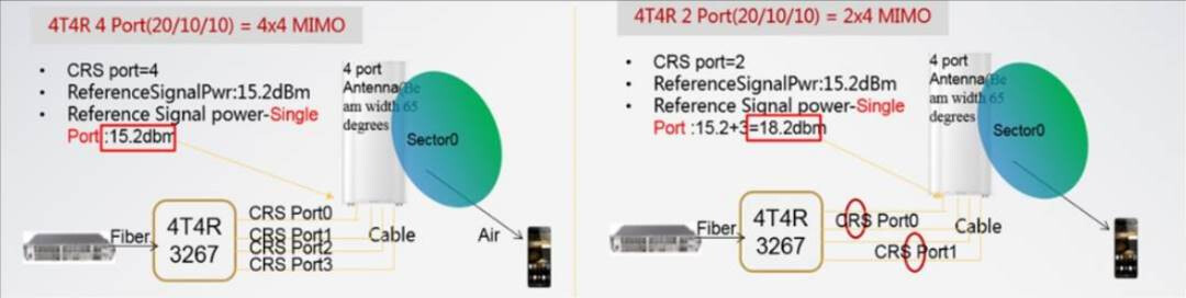

But my point is, in Huawei without reducing 3 dB from PA, by reducing the CRS port from 4 to 2, you will get 3 dB extra power than can be either added to PA or RS.

You can see the difference between 2 vs 4 Port:
Cell Power changes while channel Power which is Power Per RRU Port remain is same.
Actually the 4 ports are still in use, only CRS port number reduces to 2, the cell will be actually working as 2x4 instead of 4x4.

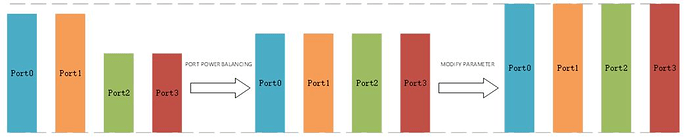

OK for this one there is a feature of Port balancing.
First you need to enable switch which will balance RS for the 4 ports and then RS can be increase.
Remaining Power Use Strategy.
If PA/PB is –3/1, the CRS power is 18.2 dBm, and the cell bandwidth is 20 MHz, the maximum port power is 40 W.
  • First step: Enable the port power balancing function to make the power of every port be the same.
  • Second step: Set PB to 0. The RE power of type B symbols on the PDSCH increases by 25%, while the maximum port power remains unchanged.
