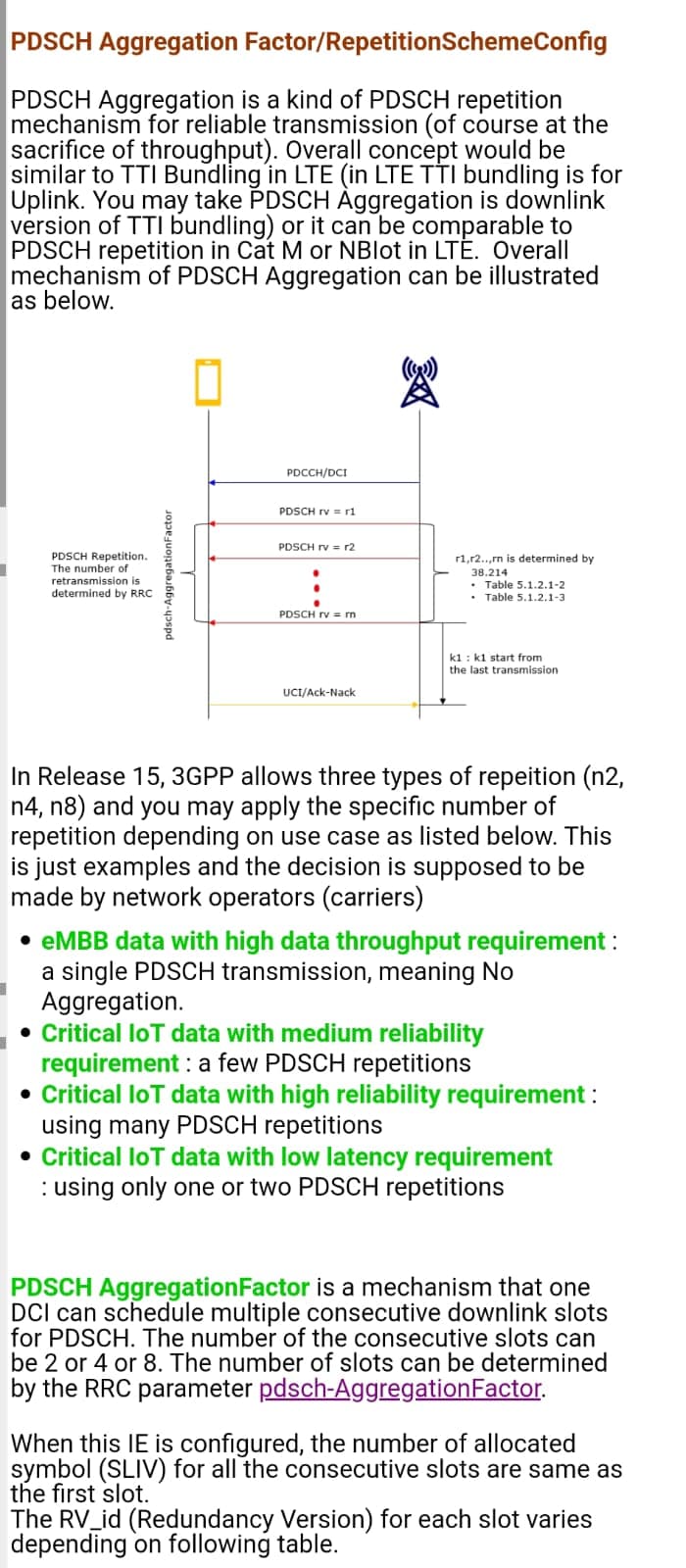

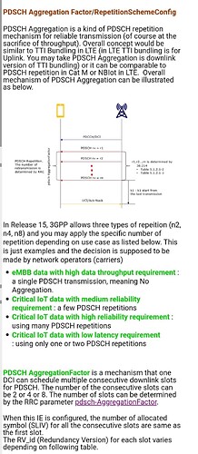

According with this info, YES
https://www.sharetechnote.com/html/5G/5G_PDSCH_AggregationFactor.html
Thanks, but this is more of repetition type.

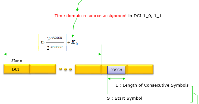

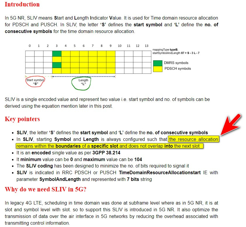

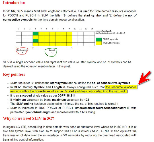

I found that, focused on not cross SLIV (Start and Length Indicator Value) boundary, each SLIV value corresponds to a specific slot index within a subframe and it cannot cross slot boundaries.
It implies that each SLIV value is associated with a specific slot index within the subframe, and the allocation is confined to that slot.
