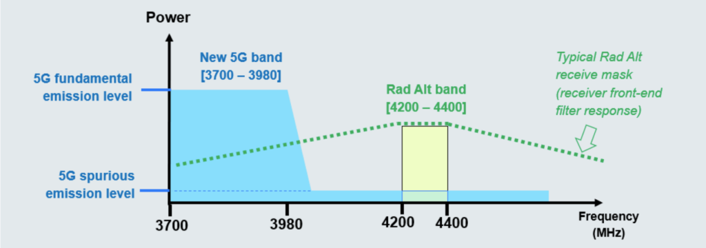

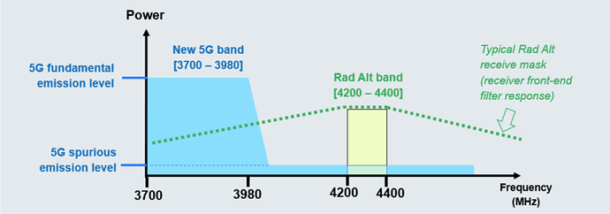

The row between the wireless and aviation industries on potential interference between 5G and aircraft radio altimeters is sounding like a storm in a tea cup! The genesis of this dispute is a report in October 2020 by the Radio Technical Commission for Aeronautics (RTCA) citing potential interference to altimeters operating in the 4.2 – 4.4 GHz band from 5G base stations operating in mid-band spectrum, particularly 3.7 – 3.98 GHz [see here]. This alerted telecom regulators to a possible interference problem that may threaten aircraft safety leading some regulators to impose restrictions on 5G radio emissions and deployments.
