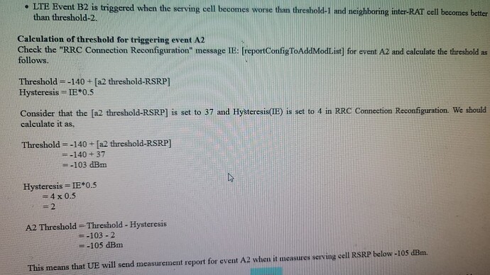

Any thoughts on this? What is -140 in the formula Threshold = -140 + [a2 threshold-RSRP]?

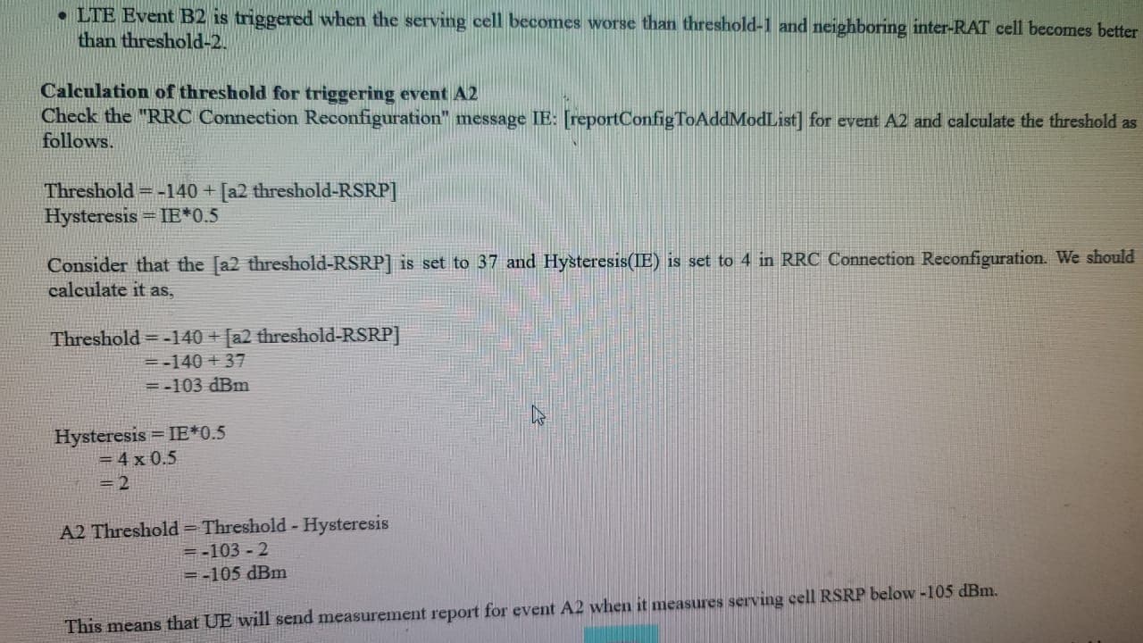

It is qrxlevmin in dBm.
Thanks.
How about the 37?
A2 threshold RSRP.
A2 event is triggered when the serving cell RSRP goes below the set threshold value in the eNB settings.

Still a bit confused about A1 A2 searchthreshold and A2 threshold.
Could you please enlighten me?
It says on the snapshot that [a2threshold-RSRP] is 37.
How it came up to 37?
What is the value of a2threshold? And RSRP?
All: any idea why it is calculating hysteresis with * 0.5?
In RRC reconfiguration msg in measurement config:
Different measurement config and object ids are defined for different kind of measurements.
For even A2 RSRP THE CACULATION IS 140-configured value of Information element in measmurment config.
So if the i.e. in RRC reconfigure message for A2 event is saying 37 means when serving cell becomes worse than -140 + 37 means -103 than event A2 is triggered.
Similarly Hysterysis IE value is calculated as IE Element * 0.5 meaning minimum hysteria can be defined as 0.5 dB.
-140 is minimum RSRP supported in LTE network in NR It’s is defined -156 by 3gpp.
I hope it clarifies,
