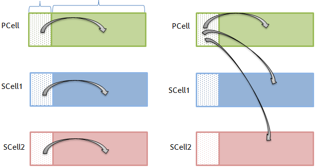

  3. It can be CROSS SCHEDULED.
NOTE : By using the Cross scheduling in CA ,will reduce the interference in between the High Power ENB’S and Small cells by using the same frequency.
Cross scheduling means: Pcell can schedule DCI for Scell, right?
Correct!
BTW, as far as I know, no Cross Carrier Scheduling actually supported by LTE UEs or eNodeBs.
From all log file I checked, DCI comes from all Pcell & Scell.
In case of cross-scheduling, it must be intra-enodeB CA, right?
Because inter-enb, it’s difficult for Pcell to know about resource status of Scell.
