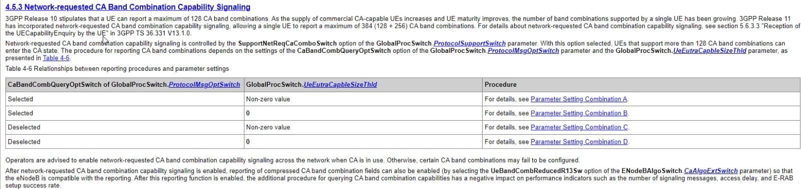

Dears, I noted an issue.
When UE report capability msg in LTE, sometimes msg size is large and contain all CA combination.
And other times this message do not contain any CA band combination.
That final issue cause UE use single carrier instead of CA so throughput degraded.
Any solution for that issue?
Vendor is Huawei.
LordGm
2
Check that one, can help.
5.6.3.3 “Reception of the UECapabilityEnquiry by the UE” in 3GPP TS 36.331 V13.1.0

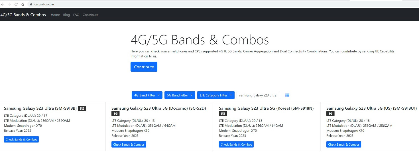

Hi All,
As per “cacombos”, I can see Samsung S23 device support 3CC NR CA between n28_n78_n78.
But when checked in actual UE capability in L3 logs, UE only reporting n28_n78 2CC CA.
What could be the reason?
Actual device model- Samsung Galaxy S23 Ultra (SM-S918B)
“cacombos” value is different country by country, operator per operator.
This is why sometime for one phone you see different links for different operators.
Here is an example:

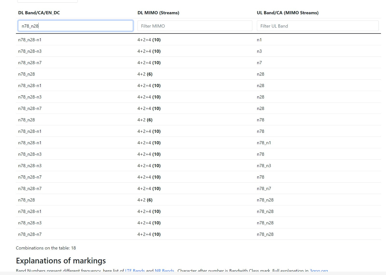

S_K
5
But every model number is different here.
I am checking first model only (SM-S918B) in cacombos and in actual UE capability which is not matching.
S918B is generic name for not branded per operator
I also checked and I do not even see N28_n78 but I seen78_n28:
So I guess It is important which one is the Pcell.
S_K
7

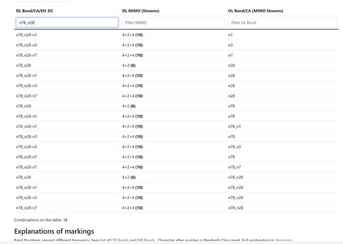

Which model you filtered?
S_K
9
You have to put proper format.
As per website it support this band combination.
But UE not reporting.
But UE reports what network instructs to report, not all bands.
Did network instruct the UE to report n78 and n28 and UE did not report it?
