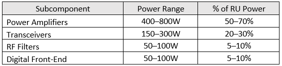

:bar_chart: 2. Zooming In: The Power Amplifier Challenge
The RU’s 40–50% energy share hinges on PAs, which amplify signals for transmission. Here’s the RU breakdown:
:fire: Why PAs Drain Power:
  • Efficiency Woes: Traditional PAs (e.g., silicon-based) run at 15–30% efficiency, losing 70–85% of energy as heat.
  • Example: A 500W PA at 25% efficiency demands 2,000W input, with 1,500W wasted.
This inefficiency spikes in 5G’s mmWave bands and will worsen in 6G’s ultra-high frequencies (95–300 GHz), making PA innovation critical (Samsung, 2025).

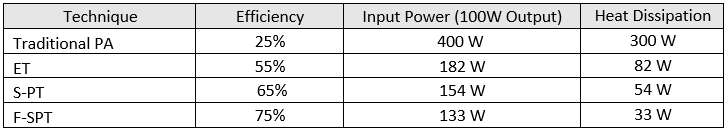

3.1 How They Work
  • Symbol-Level Power Tracking (S-PT): Adjusts voltage per symbol, matching PA output to signal needs. Efficiency: 65–70%.
  • Faster-than-Symbol Power Tracking (F-SPT): Tweaks voltage within symbols, adapting to rapid signal changes. Efficiency: 75–80%.
3.2 Compared to Envelope Tracking (ET)
  • ET: Tracks signal envelopes for 50–60% efficiency.
  • S-PT & F-SPT: Offer finer control, slashing heat loss further.
Efficiency Table:
:key: Impact: S-PT and F-SPT boost PA efficiency to 65–80%, cutting RU power by up to 60%.

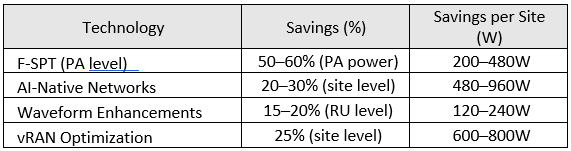

6G’s sustainability isn’t just about PAs—network-wide innovations amplify savings:
  • AI-Native Networks: Optimize resources with sleep modes. Savings: 20–30% site-wide (Nokia, 2024).
  • Waveform Upgrades: OTFS waveforms enhance efficiency in dynamic settings. Gain: 15–20% RU reduction (Samsung, 2023).
  • Upper Mid-Band (7–24 GHz): Balances coverage and capacity, reducing site density. Impact: Lower total energy use (Samsung, 2025).
  • Virtualized RAN (vRAN): Cloud-based processing streamlines DU/CU tasks. Savings: Up to 25% site power (Samsung, 2023).

6G Savings
  • Cumulative Effect:
  • PA power drops from 400W to ~200W.
  • Site power falls to 1.2–1.8 kW (40–50% less than 5G).
  • Global Savings: 10–12 TWh/year, enough to power ~1.5 million homes.
