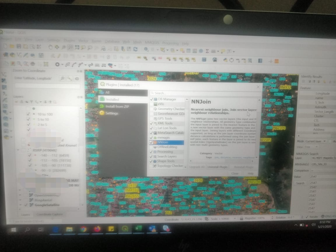

Do you have any tool or pluggins to check neighbors in 3G or 2G or 4G?
Haven’t mapped neighbors on this.
But you can search for it in plugins.

I believe this should help for your neighbor query:
Also, Python console is available within QGIS.
