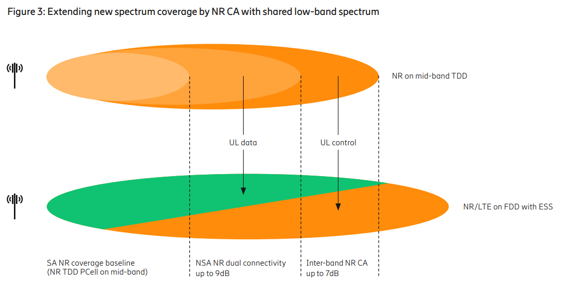

For rollouts which already have a carrier in a higher band, let’s say, 3.5GHz, deploying DSS in a lower band, let’s say, 1.8GHz, will help to expand the effective 5GNR coverage footprint be performing CA between DSS-NR_on_1.8 and NR_on_3.5.
Without DSS-NR_on_1.8, your Uplink with NR DL feedback will go through the NR_on_3.5, which will be seriously limited, impacting the overall (DL and UL) performance of NR being the UL of NR_on_3.5 the limiting link.
On the other hand, if you have DSS-NR_on_1.8 doing CA with NR_on_3.5 and DSS-NR_on_1.8 is the PCELL, you uplink will run through it, which means, you will have a gain into you effective NR footprint since now the DL of NR_on_3.5 is the limiting link.
Once again, this gain is limited to NR CA scenarios, and this is the only gain i see as an engineer, not as a marketing person.

Here you have a really nice paper which explains it in details. You are looking for this figure
