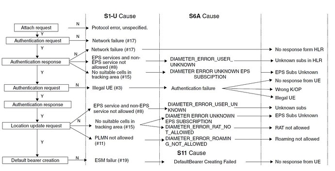

The interface of S1‐MME will associate with S6A (MME to HSS diameter signaling) and S11(MME to SGW) interface, to spot the failure reason.
S6A signaling analysis includes update location request and update location answer.
According to the 3GPP standard attach failure cause value, the problem can be demarcated. The main network reasons cause value impact the S1 attach success rate are #111, #3, and #0. For #33 cause value, the reason is that the user-initiated release message, it is suggested to investigate the wireless side combined with user data investigation.

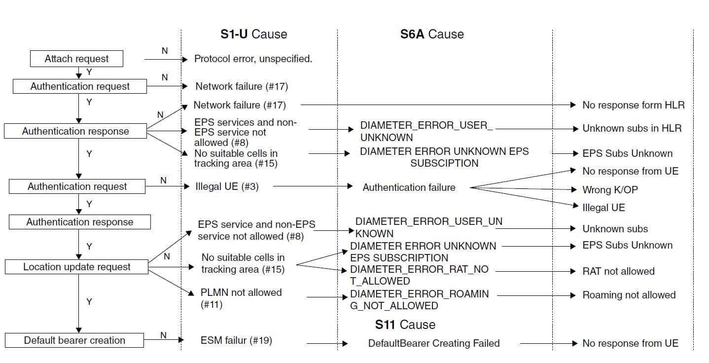

All of this information will be automatically pushed to the market for targeted marketing. (see attached figure for S1 and S6A cause values).
