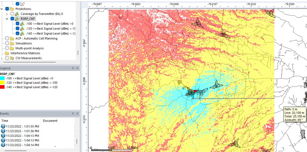

In Atoll LTE predictions, for signal level lower than -100 dBm the propagation is more than 20 km (which is not real).

For over -100 dBm is correct, but lower than -100 dBm it is crazy.

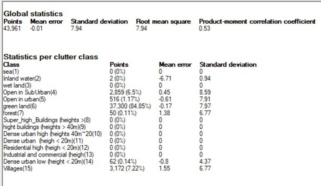

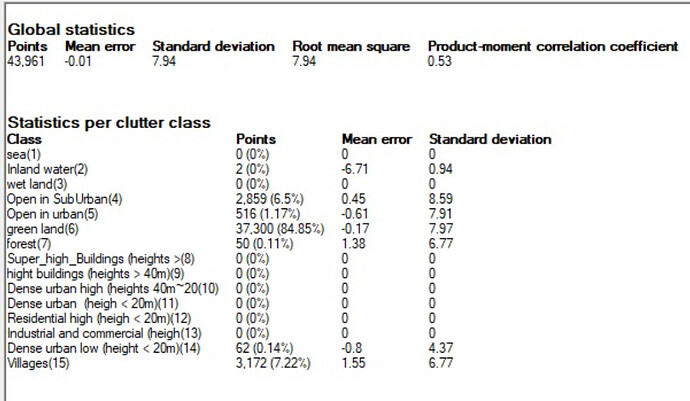

This is ME (Mean Error) and SD (Standard Deviation):

You hardly have any samples in urban / dense urban.

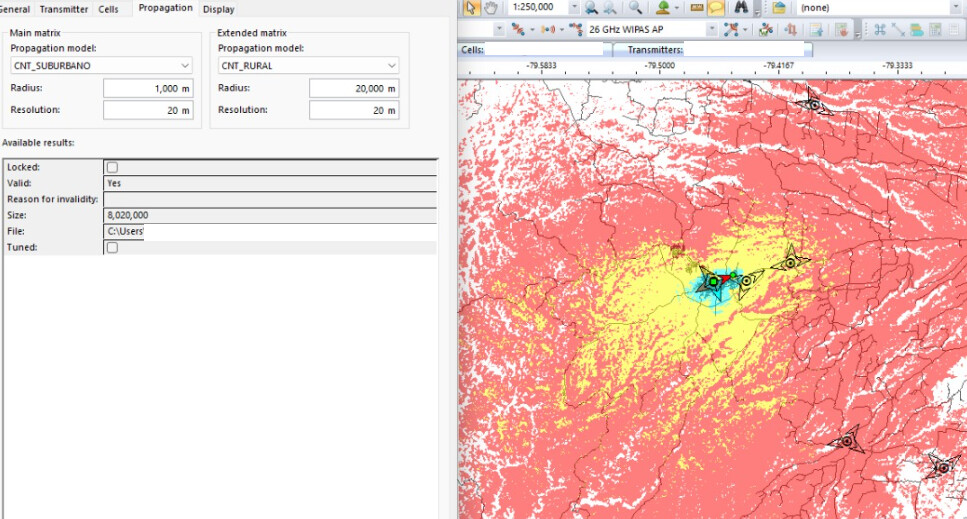

Do you mean here?

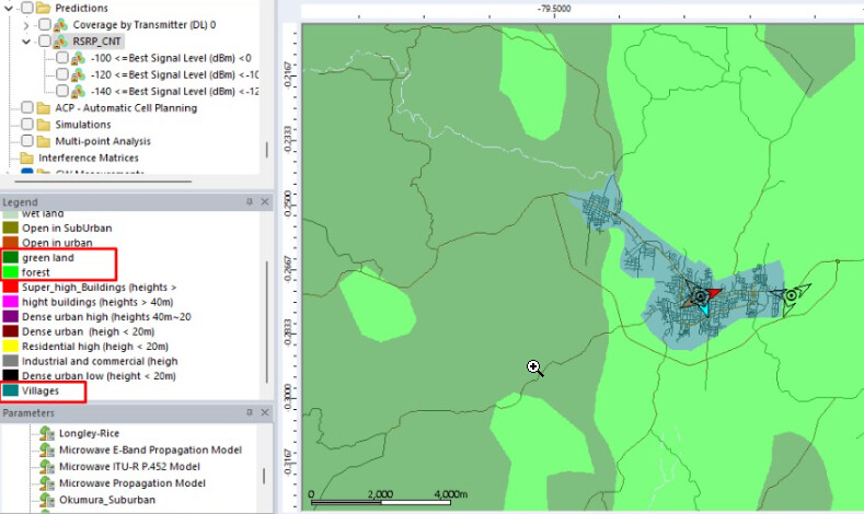

I have only 3 types:
In cell table I don’t have parameters for propagation.

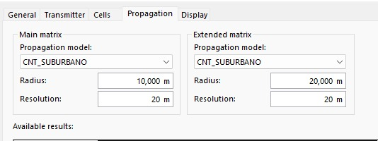

I usually use the main matrix for lower distance and the extended matrix to avoid that problem you have.
Is it correct?
Atoll Extended matrix

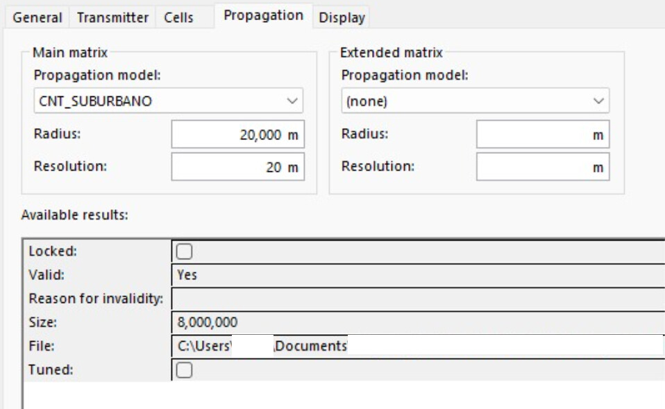

With this configuration change.
