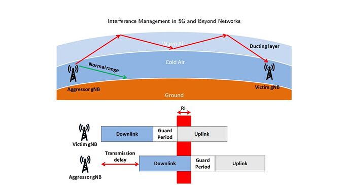

When RI is detected by a base station, it starts transmitting a special Sequence of RIM reference signal.
This signal can be used by aggressors to identify the victim base station and how many symbols it interferes.
It may additionally be used to indicate from the victim to the aggressor if enough RI mitigation has been applied or not.
The RIM reference sequence signal may also be sent by the aggressor after it has applied RIM, to indicate to the victim that the tropospheric duct still exists or stopped.

Under certain atmospheric ducting conditions, uplink (UL) reception can be significantly interfered with by downlink (DL) transmissions from remote base stations (gNBs) located hundreds of kilometers away.
As a result, UL slots within Special Slots are particularly affected, primarily impacting the Sounding Reference Signal (SRS), since these UL slots carry the SRS transmissions.
To address this issue, the Remote Interference Management (RIM) feature has been introduced.
How does RIM help?
RIM typically works by identifying the sources of interference and applying mitigation strategies. These strategies may include adjusting transmission power levels to reduce the impact of the interfering signals.
